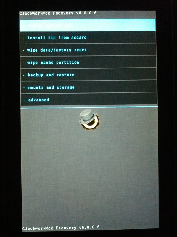

Take note: ClockworkMod Recovery has been updated since this video was made, and looks a little different as seen below:

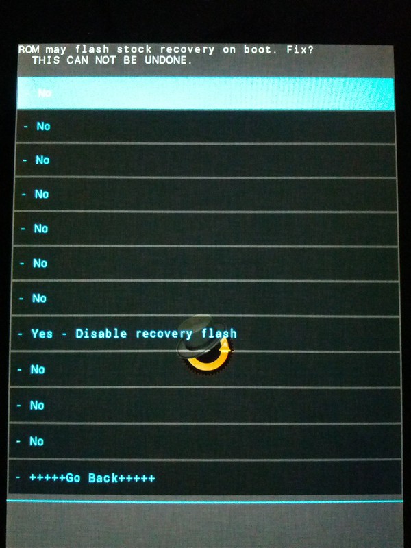

A new feature has also been added to Clockwork since the making of this video, as seen below:
Do you want to be rooted only, and keep the ability to install OTA updates? If so, select No from the above menu. Alternatively, if you aren't worried about applying OTA updates and want to be able to flash ROMs/kernels/etc, select Yes from the menu above. This is completely reversibile by flashing recovery again, so if you aren't sure what to choose just pick No. You'll be presented with the above screen toward the end of the video.
