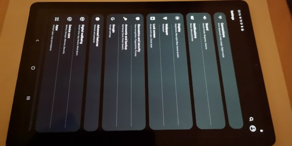

Thanks @Mooncatt, that does tend to suggest it might be an AMOLED quirk then. The other thing I noticed last night was that in night mode, the top half of the screen is brigher than the bottom half, on what should seemingly be uniformly-coloured dark panels (presumably dark grey rather than black, as I understand AMOLED is known for being able to produce true black). Example attached. Again, not sure if this is a common occurrence or a fault with this unit.IMG_20200601_231646_1366.jpg

I have seen an occasional post about uneven brightness, but not something if experienced or know much about. One of the other members may chime in on that issue.

Thanks @Mooncatt, that does tend to suggest it might be an AMOLED quirk then. The other thing I noticed last night was that in night mode, the top half of the screen is brigher than the bottom half, on what should seemingly be uniformly-coloured dark panels (presumably dark grey rather than black, as I understand AMOLED is known for being able to produce true black). Example attached. Again, not sure if this is a common occurrence or a fault with this unit.View attachment 321129
I have the same issue. On mine, when viewed in portrait mode, the right half of the screen is quite a bit darker than the left. It's annoying and makes dark mode look pretty bad.

I spoke to Samsung support about the colour / white balance issue, and they said it is just a feature of this type of screen (the guy had a similar phenomenon on his phone... I noticed a slight rainbow effect at one angle and he said he had it too, a bit like an oil slick effect). I mentioned the brightness gradient / inconsistency too, but he didn't have much to say on that. I get the impression that the benefits of OLED screens are perhaps a little bit hyped up and the drawbacks a little overlooked (assuming Samsung aren't just using sub-standard panels on this model).
