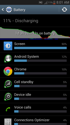

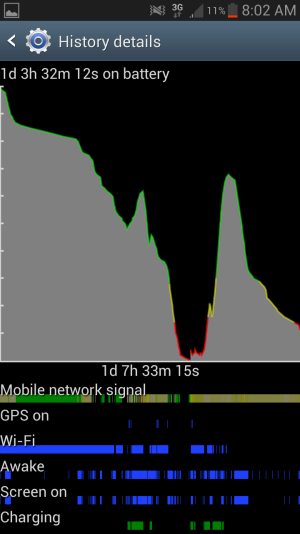

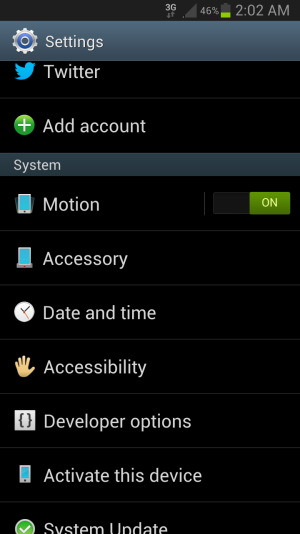

Gsder thanks for the quick reply. I didnt know that a bad data signal made battery life worse. Im gonna post a couple screens but again they might be misleading because the phone wasnt charged to 100%. I have been in a bad cell area lately. I wouldnt care so much but even if I plug the phone in and continue to use it the battery won't charge it just sits in limbo sometimes even DECREASING. I don't know if any of this is normal because I had an iPhone before. I keep brightness as low as possible.
So ive been charging my phone since the post I made earlier, which was 3 hours ago. It has gone from 11% to 48% in 3 hours, thats ridiculous!

Your screen shots are misleading. It is showing 27 plus hours on battery. Try to post a screen shot after about 6 or 7 hours after a full charge.
