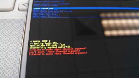

This is what my screen looks like when I boot into recovery. There are some errors.
My guess is that when you moved/cleaned up, some encrypted files became corrupted. The advantages to using encryption are obvious, but you do have to be careful about making changes to the system afterwards!
Your phone can't mount the primary data partition, so I'm pretty sure you'll have to restore your device to factory settings...here's what I would do:
1. From the recovery screen pictured in your post above, perform the "Wipe data/factory reset" option. THIS WILL CLEAR ALL YOUR DATA...but I don't think you have a choice at this point.
2. If, after you've done that it still doesn't work, then I would re-flash the factory image of the OS. Here is a link to the current software:
[LINK][ODIN][TAR][VZW] SCH-I545 VRUAME7 Factory Image - xda-developers
Now, that post provides a link to the factory image, yet no instructions on how to install it. For that, please see this thread here:
[GUIDE] No-Wipe Factory Images (Restore from any soft-brick without wiping data) - xda-developers
Use the same instructions posted here, but use the factory image from the 1st link above (instead of the "modified" image it says to download in step 1-3). You could try to use one of these "No-Wipe" images, however given the issues you describe, I'd definitely recommend using the standard factory image (that includes a full system wipe) instead.
Now, doing this will take your phone back to it's "out of the box" state, but at least it should be working again. If you decide to enable encryption again, I'd recommend not making the changes you describe in your opening post.
