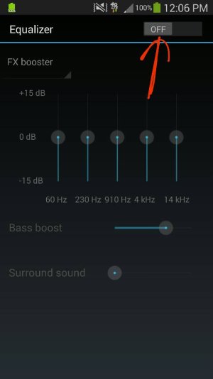

Do you have the equalizer on? Mine is off and I don't have this issue.

Almeuit -
Thanks. You nailed it. Haven't had the problem since turning that off. I must have tried to get too fancy.
Appreciate all of your input.

So I got to work an plugged my headphones in, started Google music and turned the equalizer back on (turned it off Tuesday to play around with a bluetooth peripheral I just bought) and the volume bug was still present. Turned the equalizer off and it played normally. Turned it back on and it still plays normally...
