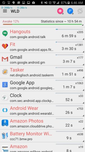

I have the Verizon Samsung Galaxy Note 5 and was able to get wake lock detector to work without root.*Adb*is required. I installed the drivers that were available when first plugging in the phone. Then enabled developer options and usb debugging. Other than that you can follow the instructions linked to in the wake lock detector app page.*
If you think you have a wakelock issue (like fast drain when idle) then you can try to use it. Keep in mind it is a troubleshooting tool, it won't tell you to do X to fix the problem

Click on the link in the previous post then look for under where it mentions for people who don't have root. It explains what you need to do.

You could try GSam Battery Monitor as it will show details for which apps are using battery.
What dpham00 shares above is a great way to get a wakelock detector installed, and if I understand correctly, it does require some advanced adjustments on the phone and using the adb tool from your computer when it is connected to the Note 5 via a USB cable.
Thus trying GSam Battery Monitor is a good first step that does not require a wakelock detector, or the more detailed process and steps.
