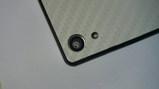

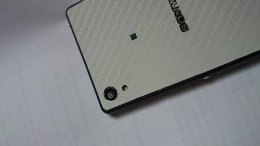

Just noticed there's condensation on camera lens, is there anyway to get rid of it

It should naturally go away with time. As energy from your pocket and the phone heats up the water, it will evaporate. It condenses when it hits a surface with less energy (colder).
If you don't want to wait, you can open the micro SD flap on your phone, hold it so this flap is up. Then lightly blow dry the camera area of your phone. Have it set to the lowest heat.
Really, you could have the blow drier ten feet away and it will work, slowly, but it will work.
Just don't have the blow drier right on your phone. In a minute or so, it should be gone. Once you are satisfied, close the flap.
