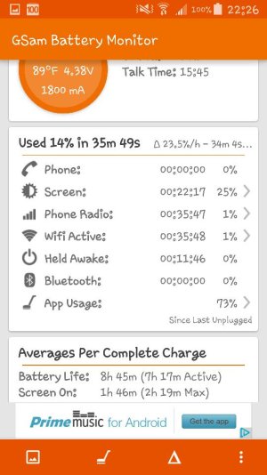

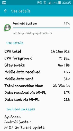

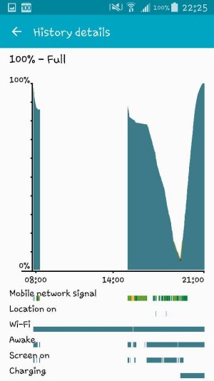

Anything look out of the ordinary? BTW, I'm on AT&T.
The mobile signal doesn't look that great around the time the battery is draining quickly--I still wonder if poor signal is one of the main problems.
Where there's no signal, it was off. It didn't move much when it was on, so I have no idea why it would be bad. I have 4 bars at my house.
But if mobile data were off, then there would be a gap. Where the steepest decline is, there's actually active mobile signal in the graph.
