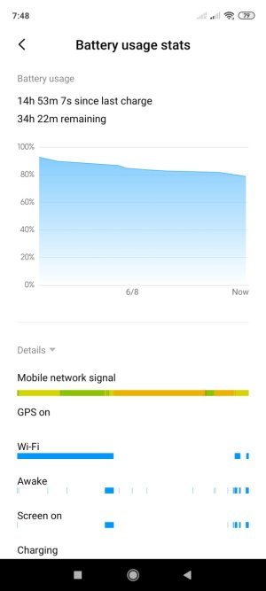

Hi. Thank you for the reply. For now here is what I got. So this is the graph from yesterdays charge. I did not use the phone. The blue marks is where I just check messenger and to clear apps and to check the time. Take note that the middle to end part is where I have the phone in battery saver mode for 7 hours. It on discharged 3% and the first to middle part it discharge 8% connected to wifi within 6 hours.
So this is the phone 95% idle for 14 hours.

Your signal doesn't look great, so that's probably part of it. To completely eliminate the cell signal variable, you can turn on Airplane Mode, then turn wi-fi back on, and then measure your battery again.

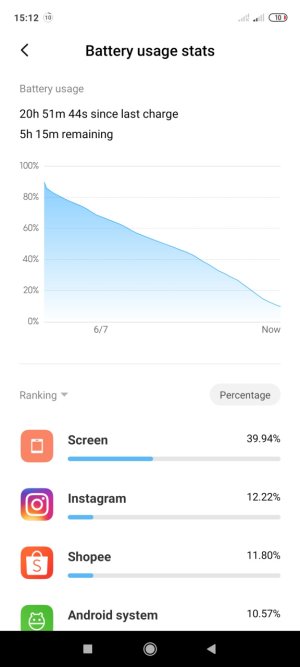

I only get 2-3 bars of signal in our place. Though my partners phone is different i dont see that kind of discharge in her device. I dont experience this with my old phone as well. I have another screenshot below. This was taken after using the phone WITHOUT turning off the screen with 50% brightness. No gaming. Browsing, social media and shopping app.
With that kind of usage over time. Am i experiencing a battery issue?
WiFi was cut off for period of time and was on mobile.
I need to see from 100 to 20 percent to get a better idea what's going on , but also it can take a week to learn your usage pattern before you know if you really have a issue .
It looks like your battery is great if you left the screen on for over 20 hours.
