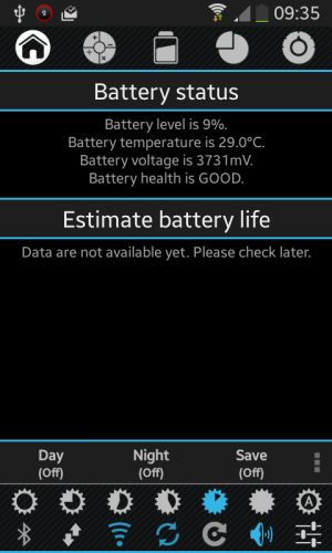

Found out that the battery was not completely drained. I left it overnight to drain completely.
Installed Battery Drain Monitor from the Play store beforehand. (First off, I noticed that it would complain about battery over voltage after a full charge).
When I connected the charger, the battery charge immediately shot up to 50%, which was bogus. I changed the settings so that the screen remains on for 10 minutes, then set up a CPU test application to hog the CPU a little.
Battery dropped down from 50% to 32% then it switched off.
Plugged in again, battery level shot up to 43% immediately. Followed above steps, lather rinse repeat until battery did not have a charge when plugged in.
Now it does not do the buzzing - battery - buzzing - battery steps as described in the OP.
I suspect I have a wonky battery. Or a wonky charging circuit - how the **** does it allow a battery to be charged up to above 5V+? The specs on the battery says 3.5V (IIRC).
Will play around a bit and see before I procure a new flattery.
then I charged it a bit, unplugged it, and got
meh :(
