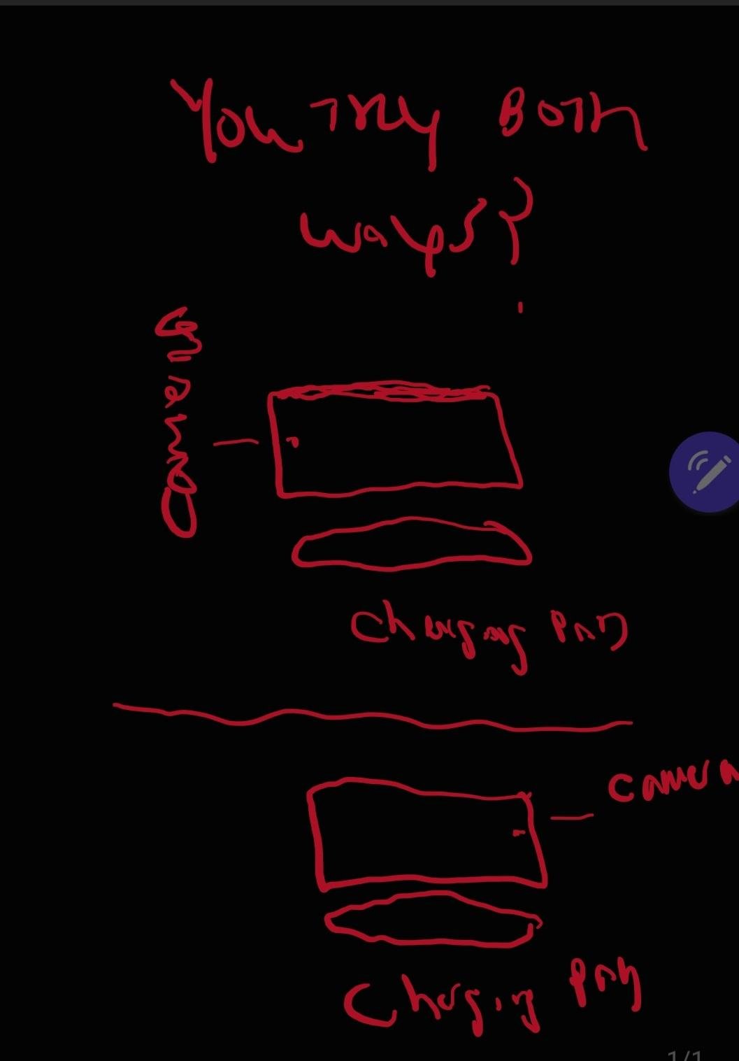

You try flipping the phone the other way , I'll show you a schematic ?
