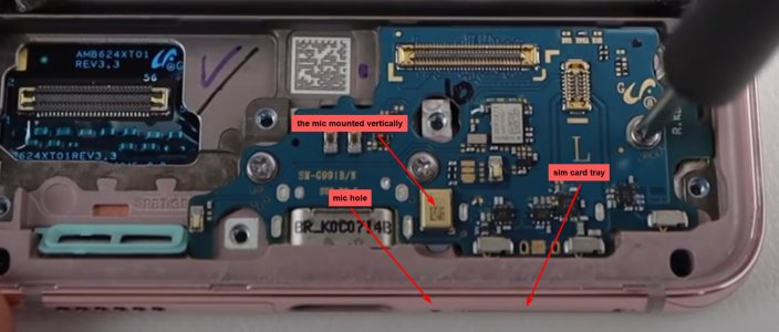

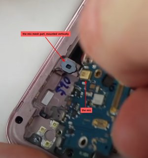

I can confirm the bottom microphone hole holds a microphone mounted in vertically.
This article talks about it: https://www.ifixit.com/News/32804/w...ge-your-microphone-port-with-a-sim-eject-tool
Also I got youtube video reference: https://youtu.be/jc1MVKh67VQ
Go to 8:15 - this shows the bottom of the s21 with the sim card tray and the microphone hole next to it. (screenshot attached)
Go to 8:22 - you can see the exact open he removes the mic board part from the phone.
Go to 8:30 - the mic has nothing on the other side of the board.
I got my S21 yesterday, I was tired and there wasn't enough light in the room so... I obviously inserted the SIM extraction tool into the mic phone.
Thank you for your research. I feel kinda relieved knowing that the mic mesh could have not been touched.
I wonder though... why they wpuld prevent us to not insert the tool in the wrong hole if a damage cannot occur? Maybe I'm overthinking it...
