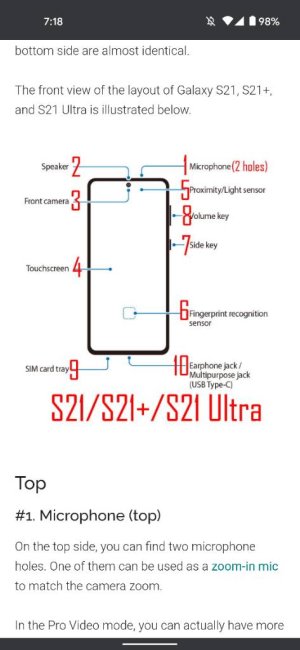

What are the two holes on top of the Galaxy S21?
Most likely microphones. If they're damaged the water resistance could be compromised.

Yes, on the bottom there is a sim tray, mic and usb-c port.
I see that too, right next to the usb port. That made me nervous as it was so close to the sim tray.
I also don't see a microphone on the camera as indicated on the diagram. But top and bottom make sense for stereo.
