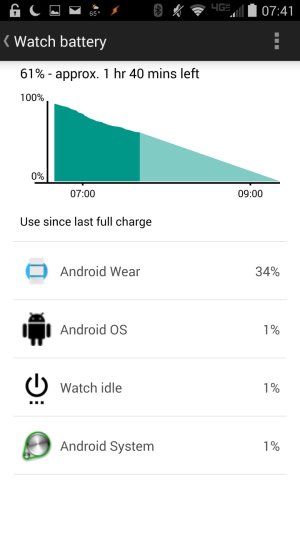

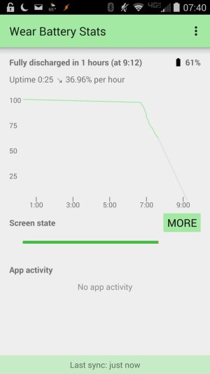

This happened to me again today. Took the watch off the charger roughly an hour ago, didn't take cinema mode off, rode my motorcycle to work, just checked my battery when turning off cinema mode and 60% left!!!!! Android Wear had taken 34% in about an hour. Luckily I have a charger at my desk. I would initially think it had something to do with cinema mode, but, I used it on a long ride on Sunday and it saved me battery life. No idea what's happening. Almost like there's a leak somewhere.
