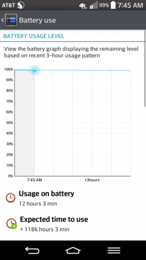

I just mentioned on another post... battery has been much better since kitkat where it's been very consistant and idle drain improved... I just unplugged last night went the full night and then some 12 hours at 100%. This phone has been the best I've ever had as far as battery life and usage time goes. Best phone I've had to date really.

Screenshot this morning... fully charged last night, unplugged and went to bed.
