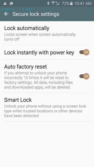

Did she have a pass code on the lock screen? If so it will factory reset after so many failed attempts.

AMDXP she does not use a passcode...she uses the fingerprint reader as her only method to unlock the phone.
Is it possible the something is triggering the fingerprint reader while its in her handbag...and since each time is considered a "password attempt" that the phone eventually resets after a series of failed attempts?

There is a setting. It can be disabled if you don't want it.
Sent from my Pearly White Verizon Samsung Galaxy S6 Edge
Don't have the last 2 options on that screenshot on my T-Mobile S6 edge, Smart lock can be turned on and off via the Trust Agents on Other Security settings, but not the Auto factory reset one.
Don't have the last 2 options on that screenshot on my T-Mobile S6 edge, Smart lock can be turned on and off via the Trust Agents on Otehr Security settings, but not the Auto factory reset one.
Mine is on Verizon. Different carriers have different settings.
Yeah, same setting I have on Verizon. First thing I disabled cause I have kids. Had a close call with that on my S5

She didn't have any password on the lock screen, so there should not have been any 15 attempts to open.

I also experienced a similar problem. Mine occurred when carrying my phone. Apparently, I caused the fingerprint to lock up my accidently hitting it too many times. Then, the backup password failed to unlock it. It finally went to unlock with Google account. I entered my CORRECT Google sign in and password (checked on a different device just to make sure). As soon as I entered them, the phone flashed up an orange Android figure and the next thing that came up on the Android figure was the term "resetting." I screamed at the phone, but it reset itself. So, no choice but to reset up the phone. However, it would only go to a certain point and said phone is locked because of an "abnormal factory reset" and asked for Samsung Account login. It took several hours on the phone the next day to get everything back together. Then Samsung rep tells me not to use fingerprint scanner to lock my phone. REALLY? That's supposed to be one of the major draws to this phone. I've had several problems with the fingerprint reader. Very disappointed in that aspect of the phone.
