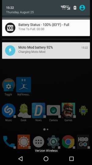

So the Aukey power bank brings up a different result.
It does give the pop-up saying turbo charging no matter which USB C to USB C cable I use. But it only charged at about 1200 mah. But the interesting thing is it does switch over and charge the battery mod. So that is good. Even though it charged at a slower rate it charged my phone from 63% to 100% in about 30 minutes. I am happy with that.

The phone was at 63% so I don't really know if there was a boost because the battery mod was attached. I will test it tomorrow without the mod on it. The big thing for me is it charged the mod.
I need to run the battery down lower and test.

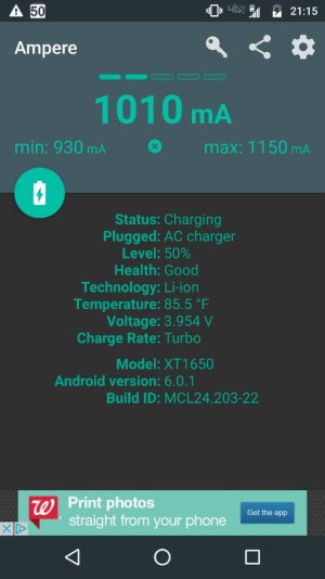

This seems to be about as fast as this charges as far as amps go. I ran it down to 49% today with some heavier use to test it. But as you can see in the screen shot it lists it as turbo charging. So since it charges the mod after the battery I'm happy with that.

I suspect that using a minimum 5V/3A charger with a cable that supports it properly is what triggers the "TurboPower" message.
This is without the battery mod attached?
