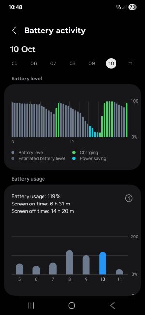

well, it doesn't in my case. For instance just yesterday, I've had it in charger at 9, and already at 15h had 30%, and also had a Google meeting with 25-20% in 17h. and it turned saver in 30% already, but I already felt anxious about it in 15h that it won't last while day, and I shouldn't use it (as I had a meeting).
So definitely not cool for me. So thats like 6 hours effective work on it.
but you see, I've noticed when I use it, even if it's just browsing, battery graph is steep.
Can you clarify this? Are you saying that it drained 30% over 15 hours? Was that was no usage at all, or with some active usage?
By "Google meeting", do you mean a Google Meet call? If so, how long was that call? Any video chat can be fairly battery intensive, because the screen and camera are on the whole time.
6 hours of SOT before getting down to 30% battery seems pretty normal to me, but it's been a while since I looked closely at those numbers on my phone.

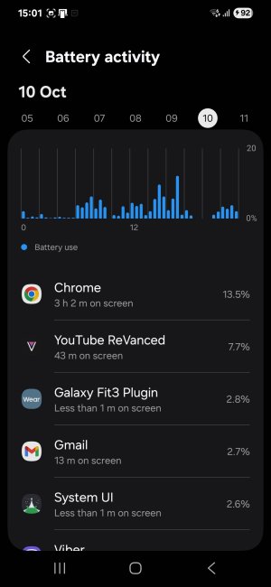

the screenshot I've sent you, that was yesterday. And where you see two green bars, that reaches top, that's when it was 9h i think (hard to tell from graph, doesnt show what hour even).
And gray bars before it, was from 00h (midnight) to 6h, and then I did some browsing on it, before topping it off to 100% before going on day, so it could theoretically last me, whilst I'm out.
And then I did 1 hour of browsing until 13h (from 9h to 13h, combined), so that's like quick searches, reading stuff etc.
And then I headed out in 13h. That's where this shows most drain, I guess it's because it was sun outside, and it went in full brightness. There's also like 35minutes of chat app, and google meet was only 13 minutes. So that's really mild to say.
That's just me, reading messages while I'm outside, and responding to them.
Google meet was in 17h , but at that point, I've already had 30-25% battery. And after google meet, it dropped to 15-10%, showing red, and didnt want to touch it. I came home, at 18:00.
But it wasnt heavy usage really. I mean, I wasnt really interacting heavily with phone. So main apps are literally chrome (3h (for whole day)) , youtube was just in background (screen off), and messaging app (30 mins ).
And it can't handle that without making me anxious, will it last to end of day.
It's always a bit difficult to evaluate battery drain when looking at a graph that represents multiple charge cycles. It's easier to take one specific charge cycle -- i.e., charge up to 100%, then use the phone normally until it gets down to about 20-30%, then show the battery usage for that time period.
Also keep in mind that when you're out and about, there's more chance of encountering poor cell signal at some point, which is one of the main causes of battery drain.
