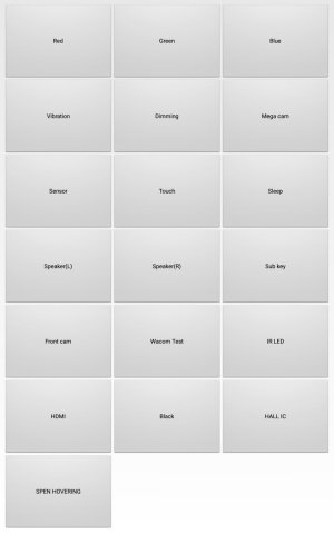

You can go directly to Factory Mode to test the Sleep fuction
1- Use calculator to enter this code to go to Factory Mode
(+30012012732+
2- Then enter *#0*# to get to test mode
Touch the Sleep button, the tablet should go to standby.
Press Home or Power button, it should wake up.
Exit the test and factory mode by using the Back button
Factory Mode is the best way to test hardware functions.

Thank you for your response. All sensors are working properly even sleep mode(with the (+30012012732+ code).

Factory Mode is used to test hardware functions, if everything is working in this mode, then problem is from software or other apps installed.

Thanks to all friends, especially Beut, the problem was solved. Probably called a self test in factory mode option that solved the problem. It was excellent. I did not think the problem is resolved. thank you very much to all.
