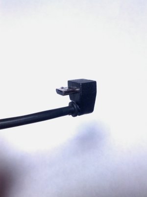

Are there any of these OTG's that have the 90 degree pointing in the other direction? I was thinking this would be a great solution for streaming movies or something but if its pointing up (?) wouldn't that defeat the purpose? This is all taking into consideration mine will be in a case that only allows it to be propped up in landscape with the volume buttons up, which again, by the look of angles would mean all the OTG's linked will be dangling there hung over twisting on the micro usb port rather than hanging down nicely with any weight resting on the tabletop.
these kind - some follks report they work - for the price you can try it and see
Pair Left Right 90D Angled Micro USB B Male to USB Female Host OTG Adapter | eBay

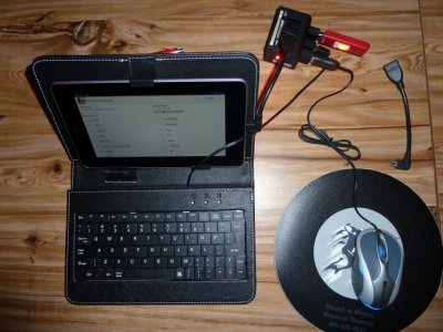

Can you please tell me what that device is on your second picture where you have the tablet and other USB devices plugged into. It looks like something that I will need.
Tks.
bigtroutz,
Tks.
That is an unpowered 3 port hub + universal Flash Memory reader adapter. Cost 4 bux or so from amazon. I got mine from BestUSA or something but here is one that looks similar
Amazon.com: Neewer 3 Port USB 2.0 Hub TF Micro SD MS M2 Memory Card Reader: Electronics
If you are going to use external USB devices or hard drives for long periods, you should purchase a powered hub so they don't suck the N7 battery dry too fast. I have this one and it works well.
Amazon.com: Plugable 7 Port High Speed USB 2.0 Hub with 3A Power Adapter: Electronics

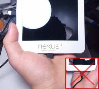

UPDATE: been on the hunt since I've seen this video
After seeing how ample these no-cable-right-angled adapters were in Japan, and not so much on English websites, I turned to Google translate.
Vendor: pocketgames
Shipping is via EMS ( in "Check Rates & Delivery Dates"). It's $12.50 shipping (2-3 days from Japan to US).
750? or $8.13 for the adapter.
For my preference of using my N7 (digital sheet music, movies, music, and general wifi) I wanted to avoid the possibility of having the plug insert damaged or loosened due to a hanging cable that would probably slide around on the music stand, or dangle and sway when I'm holding the tablet.
Just my preference for my $200 mid-life crisis. I'll update once I receive the adapter.

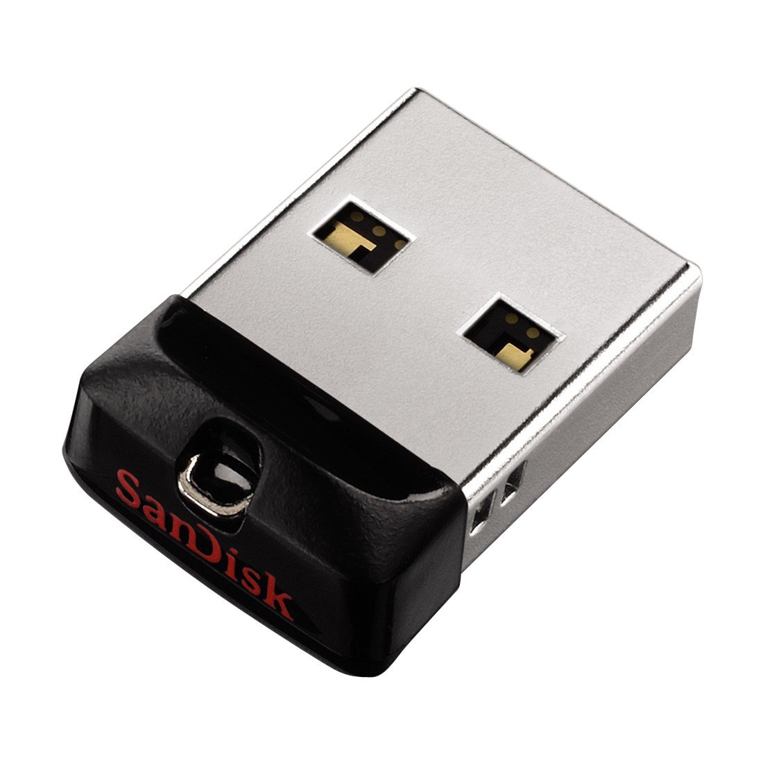

32gb Transcend Flash drive
for the read/write speeds for movies, though I'm still looking for a micro USB drive that won't stop working in half a year (based on the reviews I've read).

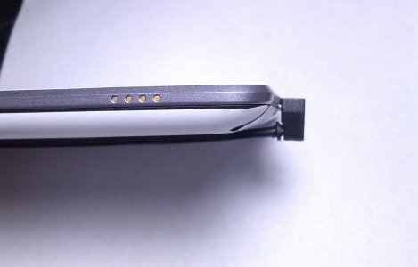

Bought one from Monoprice.com that works just fine.
Cost $1.43 + shipping. Ordered it on a Wed, showed up Sat.
That looks ideal! Do you think it would go around a case? I'm awaiting my Seidio Active case with kickstand to come in today. If I was keeping the bare feel of the tablet, I'd definitely spring for one.
It works with the TPU case I use. If the USB charging cable fits the case, this should also fit.
