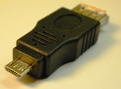

Anyways, try to get one like this:

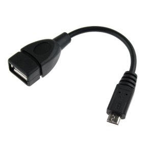

Not like this:

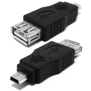

And defiantly not this:

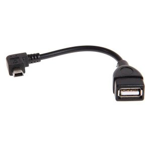

Notice the smaller tips... even this one is WRONG:
So, make sure it's a solid piece, the smaller end is MICRO, not mini, you pay $2 or LESS, and have lots of fun! There are limitless possibilities!

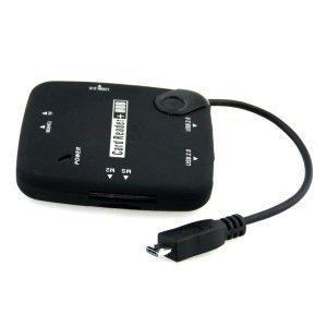

OTG Hubs? Something like this?
I'd never seen such a thing before you mentioned it. I would assume it didn't work because it was cheap and poor quality. I have used regular USB hubs with an OTG adapter before without any issues, so it's not like the phone can't handle it.
A quick search on Google and I found this... maybe you would find better luck with it.

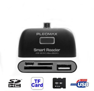

I am totally agreed with your saying. I prefer to the choice of a solid piece too. The much interesting thing is that I choose this one :Amazon.com : Unitek Mini Micro SD card reader adapter with OTG USB 2.0 A male Micro USB B male Connector for smartphone and tablets PC with OTG function, Notebook : Digital To Analog Converter Modules : Computers & Accessories. because it also bring with the performance of a card reader. Of course the price is higher. But I will see how it will make a difference from an otg adapter I used before behaved alone ~~~

That adapter can be a charger or a Mirco SD reader? I don't see generic USB OTG capabilities.
