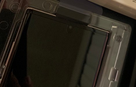

Is there suppose to be this much space at the top? Or did I get a regular note 10 protector? The box does say Note10+ on it.
Mine doesn't...How much space do you have at the bottom? Looks like the glass might have slid in between the bottom of the tray, past the two points to hold it in place.
It's right on the edge, if I slide it up the gap would be at the bottom.
Here's what it looks like on mine...I do have more space on the bottom but once I put my case on, it's all good.
Then it definitely looks like I recieved a regular Note10 screen protector in the box. I've already contacted them through amazon. Hopefully they send a replacement.
I would suggest going into Whitestone web site directly and file a warranty claim. They will process it even if you bought through Amazon. The claim process will ask for everything needed. Make sure you have pictures to show that the protector is the wrong size. Also argue not to pay the $10 shipping, since it is their mistake.
