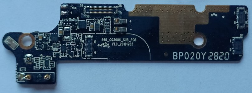

My phone is such an oddball device that I'm not convinced local repair shops will be much help. I've been getting into soldering and modding old consoles. I'm considering opening it up myself to see if I can figure anything out. Will probably be a while before I have time to do so, but I'll update with any findings if I'm able to get into it.
So, looks like the back comes off just with some screws, and the charging port is only a couple more screws and a ribbon cable. I'm ordering a replacement on Ebay (fastest shipping option I found) to test. I'll let everyone know how it goes. It may be the end of July before I have a part to try with.

Well, I can now confirm that the USB-C port was NOT the source of my problem. I received it in the mail and installed it today. I do like having a phone that I can open up with just a T5, & work inside with a Phillips 00. Sadly, it looks like software (or maybe even worse hardware?). I guess I'll keep troubleshooting and see if I can solve it. On the upside, USB ports don't fall off anymore, and I can still charge it if I restart with it plugged in.

So, interesting update. It appears likely to be a hardware issue after all. I was getting ready to try a factory restart, & decided to open it up for a little troubleshooting before doing so. I turned it off, unplugged parts, & turned it back on. After disconnecting the charging board, the problem went away. Of course, that doesn't help, but it makes it look like a hardware issue. I have ordered a replacement charging board & will update with results. Of course, life is never that easy. While doing said troubleshooting, I disconnected an antenna cable, but the connector broke on the charging board. No big deal, I'll order another cable while I'm at it. So, I unplugged the cable from the main board, but it ripped the connector off the board instead of unplugging. Looks like I have to either find a local place that can solder on a replacement connector or I have to attempt it myself. I'm not excited about either option. My phone works on WiFi in the meantime, but has no cell signal. I just bought a Moto G Power to use while I continue to troubleshoot/repair. Hopefully that doesn't just become my new current phone. Worst case, I should be able to at least get the camera and endoscope working properly again & have the old phone for just those things.
Thaks, IsbellDL, sounds like a hell of a lot of work. Keep us posted. It's still hard to understand exactly why a bad charging board would cause this kind of problem. Also seems like a lot of people have had the problem, maybe more than you'd expect to have a failed charging board (we don't know how many people have had it with relatively new phones). Also, if it's a bad charging board, I'm not sure why my problem has been resolved for four months. Anyway, thanks for posting, good luck!
Well, for my phone this issue is officially resolved. I replaced the charging board this morning, and it is working normally again. It appears that it can be either a software or a hardware issue. For those that find success with clearing cache and restarts, I'd assume it is software. In my case, it was clearly hardware. This little guy was the culprit. Now to wait for my replacement antenna wire to arrive and hope the local shop is skilled enough at soldering to replace the connector.
IsbellDL, I'm happy for you, I think you've had The Issue a lot worse than most. Maybe you're right, maybe it can be a final common pathway for either hardware or software problems. I sure wish that someone at Android would provide some clarity; lots of people seem to have had this problem. Thanks for keeping us all informed, good luck!
