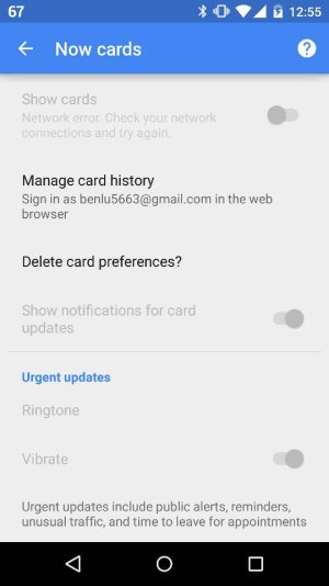

I factory reset my phone the other day and I can no longer access google now on my account. I tried with a different account and it works fine, its just that one account.
Inside the setting, Now cards -> Show cards is greyed out

If I do a search then I can open up the settings from the navigation drawer, but the option is like I said, greyed out.
Its weird that its happening after a factory reset.
That's weird. You are running Google Now Launcher, and not some alternative launcher, right? Go to Settings>Apps>Disabled​, and see if Google App is Disabled, for some reason.
Re: Why can I not activate Google Now
Here's a screenshot
Its weird and I don't get it, internet works fine and I've turning various things off and back on again.
