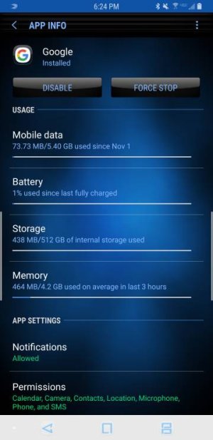

On my S9 I had to go into Settings > Apps > Google > Permissions and disable & re-enable the Microphone access. After that it allowed me to set Access with Voice Match.

SOLVED!!! - FOR ME ANYWAY using my "Mi 8" ... the solution was to turn OFF the microphone permission for the main GOOGLE app AND LEAVE IT OFF!!! ... Then when I went to do my next voice recognition, it popped something up that asked me to ALLOW access to the Microphone, which I did and it worked :)
