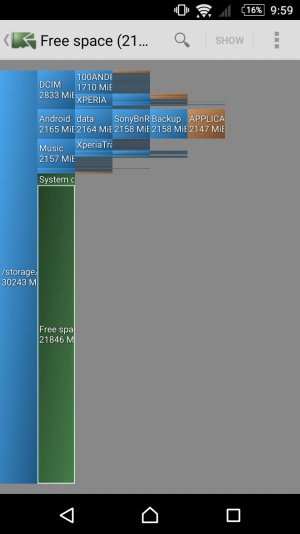

I checked Google Play services, it was taking up about 350MB, not insignificant but I don't think its the cause of my 13GB problem. However, I tried Diskusage and while it was a little hard to understand, I think it shows that I should have 21GB of free space? That sounds accurate to what it should be, but I literally had to delete an app to make room in order to download Diskusage. I've attached a screenshot of what Diskusage showed me, as well as what my Internal Storage is showing (after I deleted the 3.7GB Hearthstone app to make room for Diskusage). Does this mean that there's a discrepancy between how much storage my phone thinks it has and how much it actually has?

I would tend to believe what the phone reports. Then again, if you look at diskusage, it's reporting a lot of storage use. If you add all of what it shows it comes to about 17.5gb. Add that to what the OS (9.42gb) is taking up and that adds up to 26 - 27gb... close to what your phone storage is.
If you click on each tab on diskusage, it will break it down to let you see what app is taking the most storage. You have to look at each tab... Android, Sony, backup, etc.

Perhaps I'm misinterpreting it but I thought that each block on Diskusage already contains everything to its right, so the total used storage should only be the DCIM+Android+Music+System, as well as the couple very small blocks in between? Then it shows the 21GB of Free Space to sum up to the 30GB of storage in total.

My apologies, you're right... each block does reflect everything to the right. Haven't used the app in such a long time I forgot how it worked! :confused: Sorry about that!
