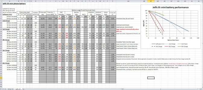

Well all was fine up to my last post. I started using the phone normally & Installed Talon (for twitter). The charge before didn't last long (2 days) which thought was down to using the calculator & stopwatch a lot. However the next two charge cycles only lasted 2 days with little use. So I backed up, did a factory reset & reinstalled the backup. I unchecked auto updates, forced stop of Google play music (Why does it keep starting on its own?) & turned off WiFi & Mobile Data. I didn't sign in to Google or Samsung accounts. I then took charger out on 100% charge. its now lasted 2 days & still has 81% battery. Again I'm not using it much, just checking the time, texts, used the phone once & looked at contacts. So not a realtime test but it certainly helped the battery a lot. I'll start to use the phone normally (for me) in a day or two & see if things start to go downhill again.
Here's my graph of the data
