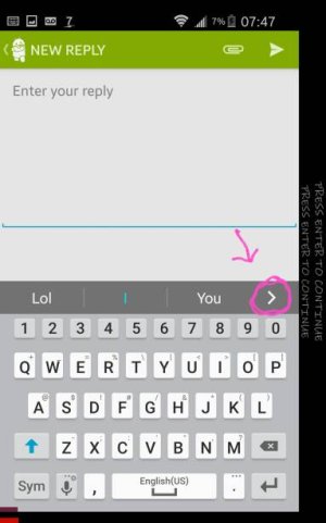

It happens sometimes to my phone also. On the keyboard, at the very top, all the way to the right ">" <---Press that arrow. Should make the keyboard go away.

Again, try pressing that arrow and the keyboard should go away.

That fix doesn't work for me, keyboard still stuck. I figured out that if you close any applications that's running a keyboard it will work fine. I'll just minimize everything until Samsung figures something out.
