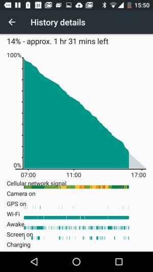

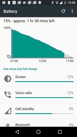

I love my Moto X 2014. <rant>I can deal with the camera not being the best but this battery issue...well it is terrible. I'm averaging about 8 hours a day before it will just turn off. I'm lucky if I get 10 hours. That 12% screen time is 1 hour 21 minutes and the 12% voice calls is 49 minutes. I think I may need a new phone but I love the stock android and the moto software. This battery is killing me. Oh and the 1 hour and 38 minutes left at 15% is more like 1 minute 38 seconds.</rant>
I think more than the battery, it's your signal and also some apps that are keeping your phone awake as per the screenshot. You should check that.
Moto X 2014 via the AC App

Thanks for the reply. The only app I leave open all the time is Smart Audiobook Player. Otherwise I keep stuff closed. I'm sure there are other apps that are "open". How can I check what is using my battery? My signal struggles at work because of the building. Not sure what I can do about that.
