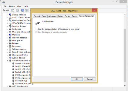

Does this happen when you connect other devices such as flash drives to the USB ports on your PC?
In Control Panel>Device Manager>Universal Serial Bus Controller>USB Root Hub do you have "allow the computer to turn off this device to save power" checked? If so, you might want to uncheck it.
