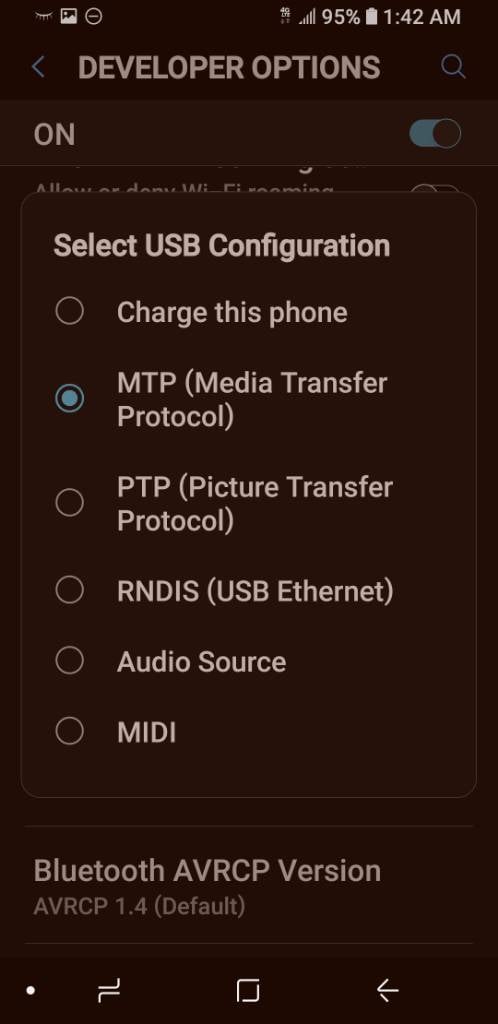

Are you getting to make a selection on this screen pictured?
Yeah that's the USB preferences. Only my choices are a bit different. On the top it will say something like the USB is controlled by: and then there are 2 options 'Connected Device' and 'This Device'. Then underneath those 2 settings there's a line and under the line a few more options that include PTP, File transfer, MIDI, etc. I'm 99% sure 'This Device' is the same as 'Charge this Phone' option on your list.
It will only show those 2 options on the top if there is something plugged into the USB-C port. So I plug in the charger, it detects that I plug in the charger to the port, but no charge. Dropping the pull down menu from the top screen will show a USB notification. USB controlled by connected device. Tapping that notification will send me to the preferences screen. Trying to change it to 'this device' fails. That's the default setting it needs to be on to charge.
