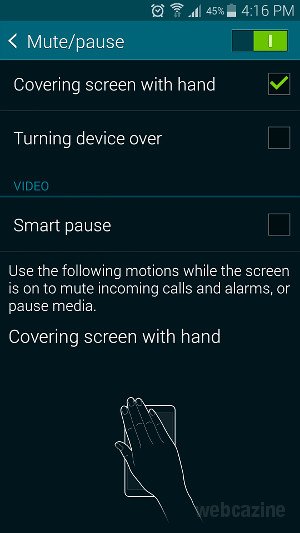

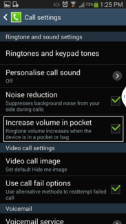

Newer devices have a feature built in that uses the G sensor and light sensor. If the device is picked up or shifted while ringing the ringer will be lowered, and if flipped over, usually face down, the ringer will be silenced. With the light sensor if the device is in a pocket, purse or other dark place the ringer volume will be increased thinking the device may be muffled. In your settings there should be one for what to do if the device is picked up or flipped over and you may have a setting for increasing volume called pocket mode or something like that. Try changing those and see if your fluctuating volume issues go away.
My feeling is something is going on while the phone is ringing, could be position, could be lighting, could be anything like that. I'm thinking.
