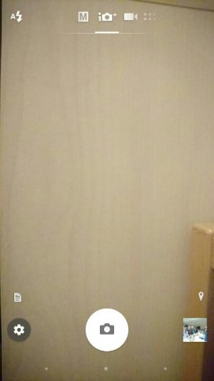

Hey,
Whenever I try to use the rear camera the display turns black while only showing the HUD. The HUD works fine, but the camera doesn't work at all. Nothing is blocking it either.
When switching camera modes (to slow-mo for example), an error pops up saying that the "camera is not available".
IMPORTANT NOTE: The front facing camera is working perfectly fine.
Things I tried to do (aside from shipping it for repair):
1. Android repair via the PC companion software
2. Internal reset
3. Safe mode
4. Clearing cache files for the built-in camera app
5. Installing an alternative camera app (the built-in one was disabled)
Anyway to avoide shipping it off for repair? The reason is that there is only one (100% reliable) lab in my country that fixes Sony smartphones and it just bums me out to do it :(
Thanks!
