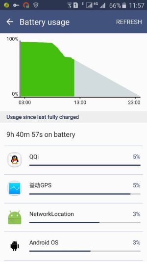

Try to uninstall the apps you use to control your battery.
I'm trying to figure out why the battery drains so much when taking it off the charger and prevent it from happening. When I took it off the charger it immediately jumped down to 98 and then within a minute jumped down to 95. Does anyone have any suggestions on how to prevent this from happening?
Try using the stock battery monitor. That app you're using might be pulling ads all the time, sucking battery with it. The stock monitor shows you which app is using the battery rather than an aggregated percentage.
I don't know why people instantly search for 3rd-party adware instead of the stock app. The app could be at fault.

My phone has been running much better on Touchwiz. When I took my phone off the charger this morning it read 99% instead of 98% on nova and just now it reads 100% after taking it off the charger. Yet I still have gsam battery monitor running. I'm starting to think it's nova that was the culprit
Weird if that's true, no problems with Nova here, ever.
I'd guess you have Tesla Unread plugin installed and set, so do a backup of your Nova settings, go to the application manager and clear cache and data from it, then open Nova again and restore your settings and see if it gets better, if not, turn off Tesla plug in and see what it does.
