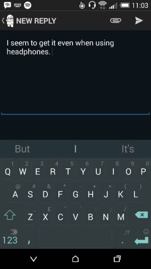

I seem to get it even when using headphones.
With your headphones plugged in, go into your phone's settings, then scroll to the device section where the Boom Sound option is. You should now be able to turn it off. It's kind of an odd setting because it's only the one toggle but it's dependent on if headphones are plugged in. When they are, the toggle is for headphone output. When you unplug them, it reverts on with the phone speakers. It does remember the headphone settings, though. I personally prefer it off when on headphones.
