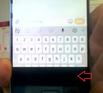

There is a black bar covering approximately 1cm at the bottom of my screen, it is covering some of the keyboard and selections to the bottom of the screen.
I can still select items so the touch screen is working.
I have done a factory reset but still there.
Help!!

I am having the same screen issue.
All of sudden, 10 days ago, without any drop or accident, a black bar appeared at the bottom of my screen.
I also noticed a sort of gray gradient from bottom to top with some flickering. It was impossible to see anything under sun light.
I did a list of things :
1. Rebooted into safe mode. Bar still there.
2. Took a screenshot. Picture was as expected without the black bar.
3. Deselected "Automatic brightness" option. No success.
4. Accessed Administrator Tools. Deactivated hardware layers and other GPU related options. Nothing.
Then some hope :
5. Rebooted into Recovery Mode. Wiped out cache. Gray gradient was gone.
As soon as I rebooted to normal mode, I noticed that black bar was not so dark. I adjusted the brightness level to max and min. Voila. Success. Black bar was misteriously gone.
I left cell at the table and, maybe 20 min later, black bar was back again. Repeated same steps as before without success.
At least the gray gradient is gone but I can not do much with this annoying black bar.
Any suggestions will be much appreciated.
