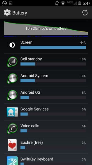

So I just switched over to a droid turbo 64gig from an iPhone (very happy I made the switch). I've had the phone a little over a week now and initially the battery was superb. Lasted close to the 48hours with pretty heavy use(getting acquainted to the new phone, downloading apps etc) these past few days however I can't even get through a day with that same usage. I did download the Nova launcher which I like alot and that doesn't even seem to show up in my battery usage as you can see. So I don't think that's it. Any ideas as to what it can be? Advice? Any help would be greatly appreciated!Screenshot_2014-12-23-18-46-44.jpgScreenshot_2014-12-23-18-47-16.jpg

A couple of things may be a clue. First, cell signal has been "iffy" with a lot of weak signal & total dropouts. Secondly, your wake time seems a little more than it should (with screen off) at least, to me.

Try removing Nova launcher again and see if battery life is back to normal. It could be Nova, just hidden under android system or Android OS.
However, I think it's a combination of high screen use and occasional poor signal. The 48 hour promise is for people who hardly use their phones and live near mobile towers and stay within a few feet of a wifi router all day.

Looking at your screenshot, in the 10.5 hours on the graph, there were at least 3 blocks of time where the cell signal was pretty bad and wifi was not connected. Also, your screen time appears to be somewhat substantial. Those 2 things are the top battery life eaters on an otherwise healthy phone.
If you click on "Screen" (as shown in the right-hand pic with 44% next to it), it should give you a total time of the screen being on...if you post that information here that can help to diagnose.
10.5 hours on the Turbo battery is a bit shocking, as I don't think I've ever had mine go dead in less than 24 hours, but if, for example, the screen was on for over 5 of those hours and the phone was doing a bunch of other things as well (including searching for signal), that could be normal.
Frankly, I wouldn't panic...yet. If you've only had the phone for a week or so, you may have just hit heavy day that ran through the battery quicker than normal. Keep an eye on it and see if the battery life doesn't start to improve and level off when it's not being used as much.
