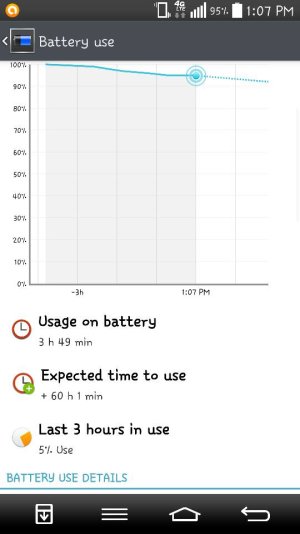

Re: LG G2 huge battery drain lately
If during that 3h 49m it had some light use, that's very good. If it was sleeping and there was no use, a 5% drop in that time is a bit high, but not too worrying. Certainly an improvement. Don't forget to report back if there are developments, either good or bad, because I'd be interested to know if you could really fix this thing.
ive been using it on n off music texting webserchs so on.. and its been good. no light use now. before when it was dying really quick that was on light use.

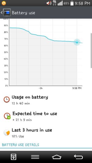

after 8 hours;
Sent from my LG-D801 using AC Forums mobile app

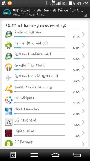

you can see now the system is at 11% rather than 40%
google chromes not on the list but i was on there webbrowsing so must not have used alita power to not be on the list

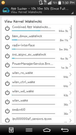

any idea what wakelocks do? i was looking at them on gsam batt monitor.

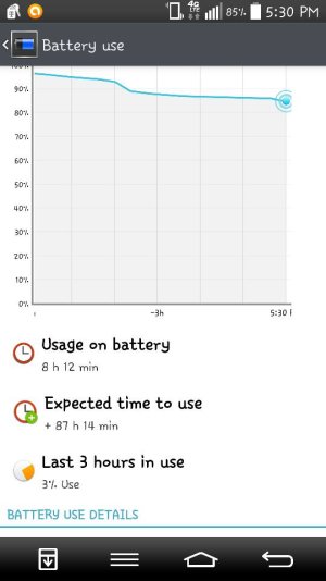

only used 45% so far
