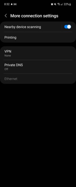

Then go to setting>connection>more connection setting is private DNS off ?Screenshot_20230130_083255_Settings.jpg
More connection settings - all is off, even the one you have on. I have Rich communications options as well, which is turned off as well.

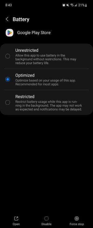

When you long press play store>tap info>scroll to battery and tap make sure it's at optimize or unrestricted not restricted?Screenshot_20230130_084332_Settings.jpg

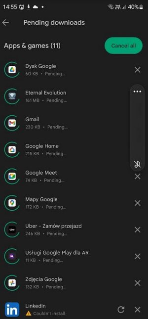

Was optimised as on your screen, changed it to unrestricted - nothing changed. Currently I can see 11 apps to update, and they all in pending or failed state, one is trying to be installed.
Then it moves to failed, and another one is trying. If I will turn WIFi off, they will be downloaded without any issue.
You can put it back to optimize

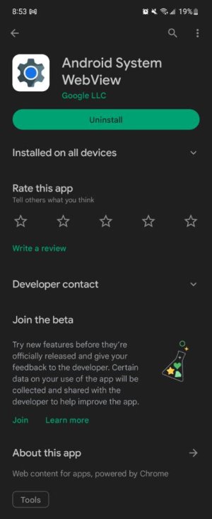

Also go to play store and find Android WebView and uninstall the update to it Screenshot_20230130_085337_Google%20Play%20Store.jpg
No Parental, Im too old for someone to give me parentals ;) Its the other way around ;)
Sadly no change after uninstalling the update.

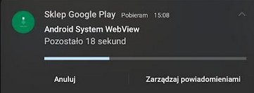

Basically this is how it looked before uninstalling that update:
Nothing changed ;(

What im curious is, that if you look at the picture: screen2.jpg
You will see that progress bar is gradually being filled in - which is visible until I can see that the downloading is actually ongoing. At the moment it freezez I can see milisecond blink on that bar and its empty. So I can be on 97% which is stuck and progress bar is changed to empty.
