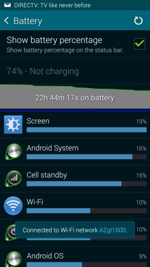

A typical battery stat for me, is about 25% use per 24 hours....
here is my screenshot. If you look closely, you can see when the phone is idle. The battery discharge line is FLAT lined. Likewise, you can see when the screen is unlocked and the internet is turned on again. The typical downhill discharge graph with use.
then the screen is locked when I am done with it, and the discharge line Flatlines again until the next time the phone is in use.
there is a LOT to be said for controlling access to the internet. If the phone is idle, it is pointless to be wasting battery power.
