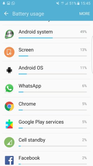

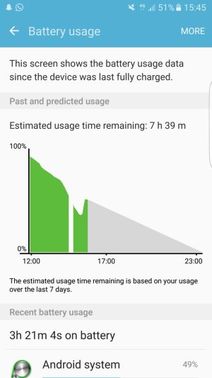

my screen is usually on a low brightness,gps usually off, however here is the most recent stats after charging for a littlwe while when i got home.

Your cell signal doesn't look great in that screenshot. Use an app like GSam Battery Monitor to see what the cell signal strength is like throughout the day. If it's constantly poor, that can definitely impact battery life.

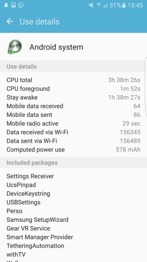

Your android system is incredibly high, more than half your battery is going to that, i would recommend a cache partition clear, if that doesnt work, remove iculus updates and delete some known battery draining apps, if still no use factory reset and add your apps back 1 by 1 slowly. Your phone shouldnt get hot ir drain battery especially while off, mune never did that. My D7E was actuay the best flagship battery i ever owned even better the the droids of these years
