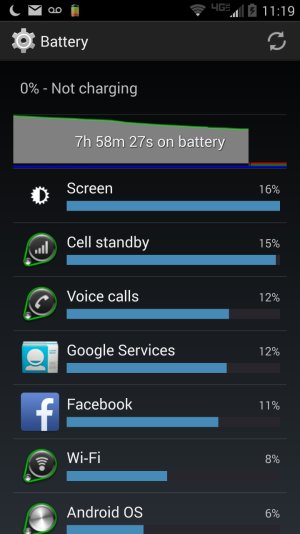

I switched from the iPhone to the droid turbo a couple weeks ago. I have now had multiple instances where the phone will go black and not turn on. If I call the phone from another one it will ring as if it is on but nothing will show on the screen. The first time it happened I was near a Verizon store so I took it on in. They were stumped and after about 45 minutes they came to the conclusion that I have to use the turbo charger ALL the time. I had plugged my phone into my husband's once for his galaxy...so I went with that answer... After a couple hours (and not plugging it up because I was still out doing errands) it turned back on by itself. The charge was at 68% so the battery didnt just die or anything. Well everything was fine until that night. I put it on the turbo charger and went to sleep. When I woke up it was still at 7%. I looked at the battery screen and it had the symbol stating the phone was charging. But then it said 7% - not charging. I restarted the phone and it basically kick started it to work again. Well fast forward to now. It did it again tonight. Went black, wouldn't do anything, brought it home and put it on turbo charger. Left it there a few hours and went back to see if it would turn on. After an hour of messing with it I found that if I unplugged and replugged the phone into the charger I could hit the on button some kind of a right way with the charging symbol up to turn it on. (During that hour i would sometimes see a charging screen then a charging screen with a question mark. Then it woukd go black and nothing again) When it turned on the charge was 0%. (It had been sitting on the charger for awhile). Well I thought about the last time it happened and tried to restart. Bad idea. Took me another hour to turn it back on. Still at 0%. It has been on and on the charger now for 2 hours and still nothing sitting at 0%. I'm not daring turn it off and back on again. Does anybody know anything about what's going on!? Please help!

No it doesn't get hot. I plugged the phone into his and it shut down and did nothing. Couldn't even get charger screen to appear. Just had to plug it back in to turbo and turn it back on. It would make sense if its the charger but at the same time it charged fine for about a week between the two instances. Not only that but I'm using the phone right now. Its been on 0% but its getting some kind of a charge still to stay on.
