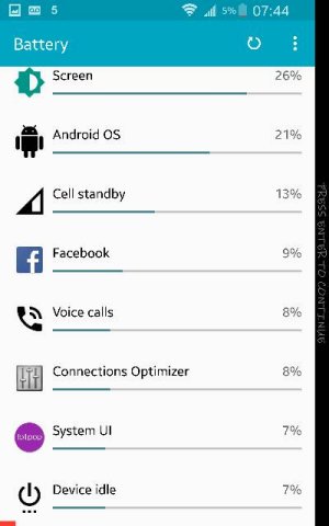

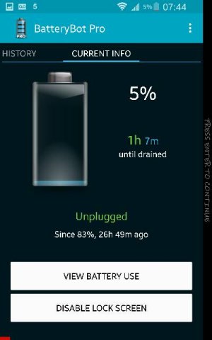

Not gonna believe me so I'm going to post the pics...
Posted Via Galaxy Note Edge. Yea, the phone is perfect...

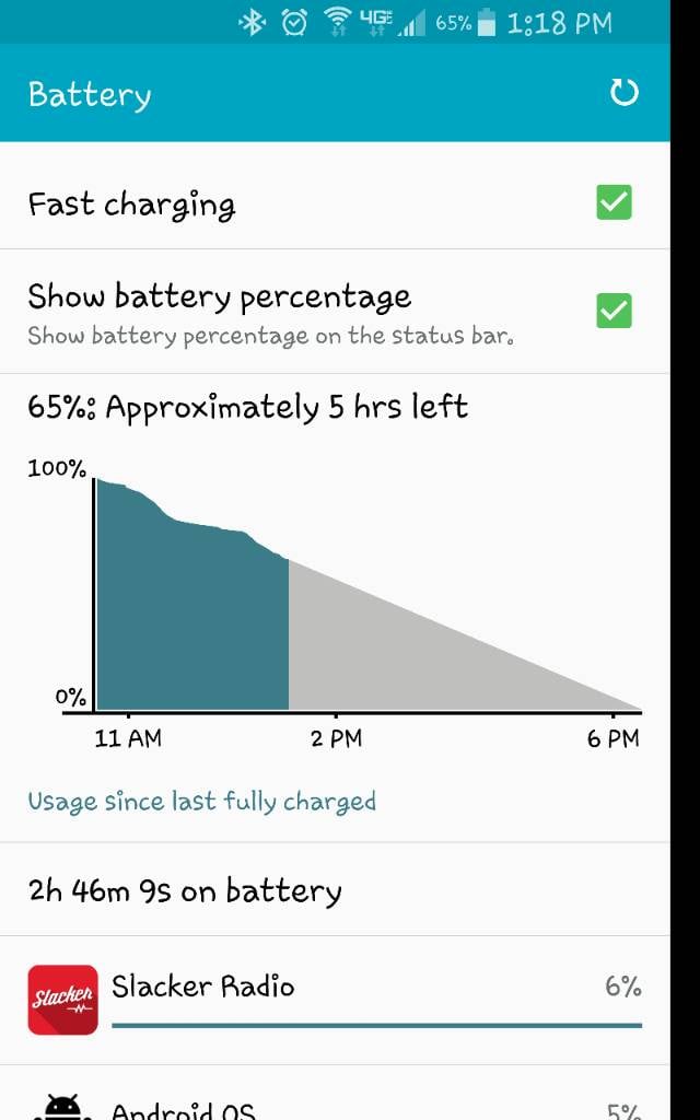

Is anyone else having this bad battery life. Screen on time is 1 hour 6 minutes. Slacker was a hour.
I have the screen set lower brightness then my note 4, the note 4 battery lasts a lot longer, and I know note 4 battery is bigger, but not that much bigger.
Just curious if this is normal or maybe the battery is shot. And battery dropped 3% doing this post.
Thanks
Sent from my SM-N915V using Tapatalk

I haven't read all the comments but mine increased once I stopped doing the quick charge option.
Re: Galaxy Note Edge -- Battery Life
How do you choose or not choose the quick charge option?
Go to settings, power saver, and unchecked the box marked "fast charging"
