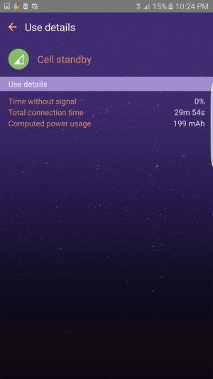

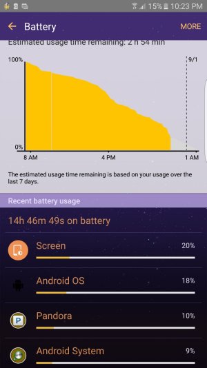

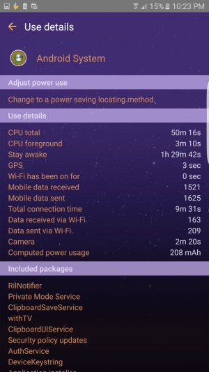

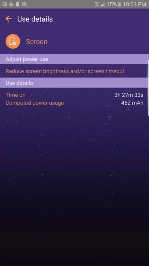

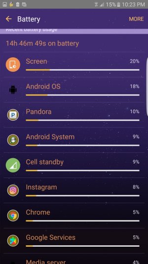

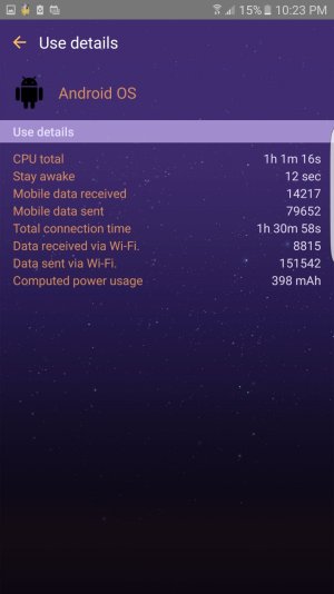

Hello, I have been an Apple user the last few years and have generally experienced good battery life without having to turn off a bunch of things that are useful for a smart phone. However, I have had this new phone for a few weeks now, and I am not impressed with the battery life. For everybodys' information, I have AT&T. I have had battery saver mode constantly on. I have disabled various wifi issues (always scanning, smart network switch, enhanced services) and it seems to still be a problem. I will post pictures of my battery usage data.
That looks like a reasonable run, you have an amazing powerful device with a super bright screen! Marshmallow is a bit kinder to battery life, and the S7 is better still! It also depends on how solid the network signal is in your area... I have an external battery pack on mine and it goes forever....
How much total Uptime did you get on your iPhone?
If it's both 14 hours, I'd say there's nothing to worry about.
Remember, iPhone "Usage" figures and Android Screen On time aren't the same. You can't calculate Screen on Time on iPhone unless you're literally using it non-stop.
Thanks for the replies. I don't remember what my total uptime was that day. Ill keep an eye out for that. If it looks normal, I guess I just need to get used to it! Thanks again
This may or may not be your problem, but I'll relate this because I've had two separate instances of my GS6 Edge+'s battery going down more quickly than normal (and the phone heating up more), and both were due to the system app "Media Storage" acting up.
I found the fix on Google once I saw that something called mediaserver was using a lot of juice. I see in your second screen shot that Media Server is using 4%. I don't recall if that's ok or high (mine is only using a very reasonable 0.8% after a recent "cleaning").
To fix a runaway mediaserver in Marshmallow, go into Settings --> Applications --> Applications manager, tap "More" and select "Show system apps". Find app "Media Storage" and tap on "Storage", clear cache and clear data, Force Stop the app, and you're good to go (media knowledge will eventually be rebuilt by Android). IIRC, it has something to do with media server being confused and constantly building its database.
