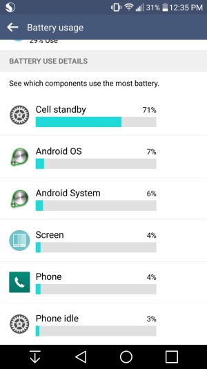

My phone, lg g4, has been draining battery by a lot while I haven't done anything heavy for a day
My phone, it's currently using 69% of my phone's battery, while other's are below 10%e's battery has been drained mostly by cell standby according to my phone's battery usage. Is there a fix to this?

btw this is a picture of the battery usage

It saids its about 12hours and 45min usage on battery, also it's on Rogers, in Canada

Yeah that's not good. Your losing about 5% per hour in what appears to be very light usage. You probably have a rogue App or service wakelocking your phone and not allowing it to idle properly. These can sometimes be difficult to diagnose without root though. You may want to start by uninstalling Apps, one at a time, in order of what you think might be the most likely culprit. You could also go full bore and try a factory reset, then install your personal user apps slowly while you monitor idle drain. It's a bummer but these issues can often only be solved slowly and through trial and error.

Your cell standby is way too high. Mine usually runs about 6%. My screen is always highest %.

Tap the graph and look at the bottom of the next screen. Is the mobile signal solid green? If it's yellow, brown or red, you have a weak signal (IOW, you're using the wrong carrier) and it's going to cost you battery.
