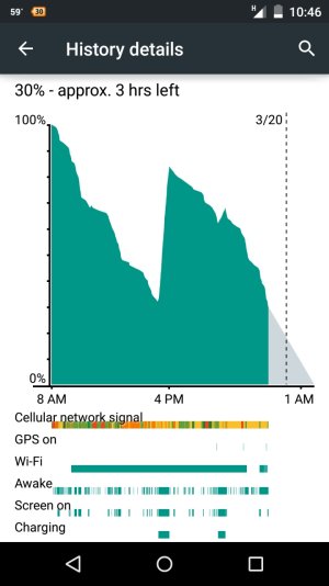

So it started happening again this evening. Battery dropped from 52% to 30% in just under 2 hours with the phone practically sitting idle, with me checking a quick email or two. Attached is a screen shot of the graph details - Screenshot_2015-03-19-22-46-32.jpg
I think maybe it's your cell signal which looks low judging by that graph. If you have cellular data on and set it at LTE in a low signal environment, I think that puts a lot of strain on the battery, as the phone keeps trying to connect at a higher speed. This is the case in my office. So when I'm in there I always switch to 2G and no cellular data. Battery drains much slower after that.
Hmmm...after I took this snapshot, I turned off WiFi and it seemed to stop the battery drain. I am wondering if it is WiFi or some settings related to WiFi that might be causing this.

Turning off WiFi like you did helped me a ton. Also disabling google now helped me. I enable WiFi when I need it.
