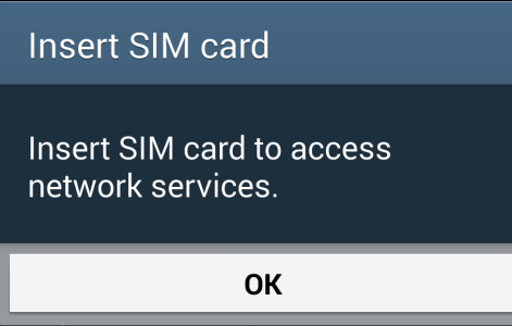

You know, that's one of the first things I did. I contacted T-Mobile and they asked me to do just that. The problem is that I kept on getting the same error message:Screenshot_2015-12-01-21-12-47-1.png
