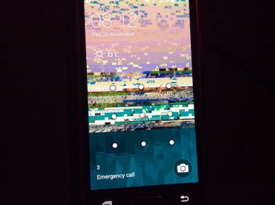

On Tuesday I woke up to a message saying i needed a software update, I made sure I was on WiFi and then did the update so I am now on 4.4.2 however since this update whenever I have whatsapp open or recently closed and my phone goes to lock screen I now get this horrible messed up screen that's pixilated with half of my lock screen and half of my whatsapp background, see attached pic. also now when I open my phone none of my apps are on the screen its just my wallpaper picture and I have to scroll left twice before anything becomes visible and then another two times to get back to my home screen. I've checked my whatsapp on the play store and there are no updates available so I am running the latest version of this also, getting really fed up with this phone now.
As you state that the problem coincides with using Whatsapp (I don't use it so haven't experienced the problem) have you tried notifying the developer of the app as it may be a known problem? One other thing that you may want to try is to do a factory reset in order to start afresh as this sometimes helps. Obviously you would lose any saved app data but you may judge it worthwhile. But it does sound more like an app problem than a phone problem. One other thing that may be worth a try is to wipe the cache partition. You won't lose data and you can find details on how to do it by doing a search as I can't remember the specifics off the top of my head. It involves booting into recovery by holding power and vol down (I think!).
OK thanks I will look into doing that cache clearing see if that helps, I don't want to do a factory reset until I can access Samsung kies and do a full back up
