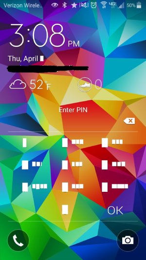

My Galaxy S5 is no longer showing numbers on the lock screen. It just shows little rectangles and I'm not able to unlock the phone. I've rebooted the phone, but the lock screen still doesn't show numbers.
That didn't work.
The screen will still unlock, but the numbers/icons don't show and the date and notifications are wiped out partially.

Tapping the buttons did work to unlock the phone. Phone started crashing last night. Ended up taking out the battery and everything is fixed now!
Re: Galaxy S5 lockscreen not showing numbers
Mine was doing that yesterday. For me when I hit the numbers they still worked. I also used the button on the right side to bring up the menu and hit restart and all was good.

They had removed the battery and reinstalled it.
Hi there,
I had the same thing and remembered where the numbers were for my password so got in and then held the button on the right until it said restart. I then hit restart and now it's back with the numbers again.
Cheers:)
My s5 does the same thing and has done for awhile. The reboot of the phone is only a temp thing until next time. No one here has mentioned a cause or a fix, they only mention a temp solution. An answer would be nice ...... a real permanent fix better still.
