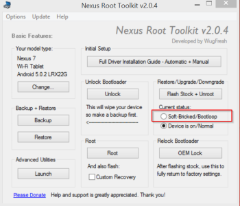

Best option and probably the easiest would be to try Wugs Toolkit on your computer. This should be able to get you back up and running. WugFresh | Thoughts + Development
Once you install and open the toolkit, after the initial updates to the toolkit you will want to use the following options in the screenshot below under flash stock + unroot. Follow the prompts and you should be able to select your choice of which version of OS, in your case Android 4.4.4 to flash into.
Feel free to stop back and let us know how things go!
